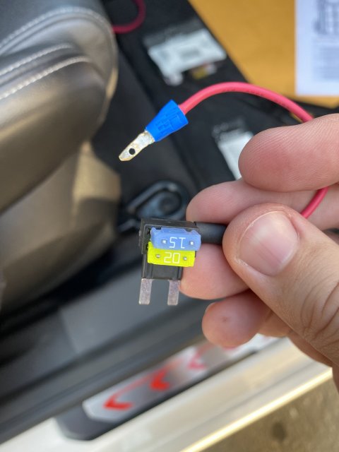

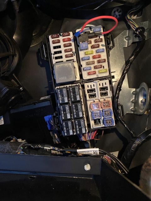

I need your help with this. I'm sure it's been posted in here, but I can't find the keyword combo to bring it up. I've had my '16 FiST for about a week now and the Sync has several issues stemming from the fusing. It is currently fused with this bridge to the BCM in Fuse 11 to enable it to power off with the vehicle, but that means that thee sync does not remember anything when it powers back on, the bridge falls out of fuse 10 pretty easily, and it wants to update every time it starts up so the whole process takes 30 second to clear out and get to a radio station (and the updates never succeed). If I replace the bridge with two fuses in fuses 10 and 11 the Sync module never turns off and I'm afraid it will drain the battery, and I'm waiting for an OBD reader to come in that my FORScan can connect to (I only have one that Carista connects to). Does anyone have a work around for fusing this that will cause the Sync to power off with the car and not destroy the battery? I appreciate the help!

If you're not using the add-a-fuse (maybe the installer used it for a dash cam or radar detector) then you can just take it out and replace the fuse directly in the slot in the fuse box. Sync has a 10 minute delay, from turning off the car's power, until it powers down.

10 min delay? That's absurd. Is that editable? I'm thinking that's why the add-a-fuse was put in there by either the previous owner or the shop that salvaged it. With the add-a-fuse it powers off with the vehicle power, so I'm guessing that's the purpose of adding it. It also keeps power on for the USB ports in the armrest, so my GPS stays on too. Worried that two will drain the battery if I leave it plugged in, but it's super inconvenient for a modern car.

Not sure if you can change the delay. You can check the forscan thread to see if there's a setting. Not sure why anyone would use an add-a-fuse in the manner you described. Again, if you're not using the add-a-fuse for anything, just remove it and put the 15a back into f10 and the 20a into f11.

I hadn't really got into the FORScan threads yet because the Amazon shipping is so behind right now that it'll be a few weeks before it gets to me yet, but yeah I had planned to search through there for settings and such, just wondered if you knew off hand. And yeah that looks like what the add a fuse is set up for; I had taken it out and done what you suggested it to see that the sync didn't shut off, but hadn't let it sit for more than about 5 mins or so.
