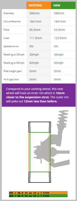

I'm looking to go down to a 15x7 Team Dynamics 1.2 so I can start utilizing popular miata tires for track days. Currently they offer +15mm, +23mm, +35mm, +40mm, +42mm. +45mm. I would like the wider track of either the +23mm or +35mm and to match the fitment of ryan15 (below). He states his is a +30mm but with that not being offered I'm assuming he meant +35.
Per Will They Fit, this is the fitment between the two:
So my question:
Can someone show me the physical fitment difference between the +23 and +35?

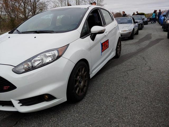

15x7, +40mm Sparco w/ 205/50R15 RS-RR's. The +35mm would be 5mm per side farther out to give you an idea. Right now it kicks rocks at the 1/4 and 3/4 panels pretty badly so i can imagine the rear getting it worse with a wider track.
No rub issues with a +40 in 15x7.
