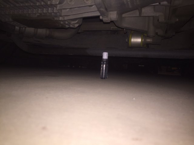

Totally non-scientific, but here is a shot of my bar clearance while riding on stock wheels/tires with the Swift/B6 setup.
The Purel bottle is about 3.25 inches tall, so guessing about 2.75-3 inches of clearance? The 225/45R15s drop it an additional .5 inch or so.

#19
Ah, I see your point now. Is that bar your trac bar? I am planning to get a TB Performance bar so it has more clearance.
yes- the bottle is sitting flush up against the Pierce 2 point lower chassis brace/ tiebar/ track bar thing. One thing I noticed is that the lower flexible bit of the nose is about at the same level as the bar.
