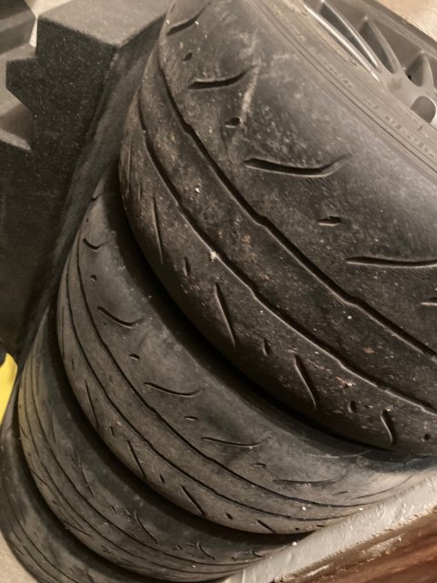

I did 12 events with anywhere from 6-10 runs per event. I also left the tires on the car for a lot of the summer, getting a couple thousand miles that way because COVID had me working from home.
Here's a picture I just snapped today:

Thanks for info and pic much appreciated.

I appreciate the photo and thank you for the info. Looks like 660’s it is.

Definitely NO funky center strip separation on those! [twothumb] [raceflag]

The weird thing is that I did have a bit of the center rib of two of the tires separate and strip away early on, but then the wear just evened out and things seem to be fine now. It was concerning at first, but they kept on working fine and I think they still have some life. I'm planning on ordering another set once I can be fairly confident they won't freeze en route.

That's good to hear. I'm sure the fresher sets won't have the same issue. I'm very likely buying the 660's this summer to continue having fun in SMF, my RS-Pro's are at 4-5/32nds and its spin city even on the stock turbo unless they're hot making my first 2 runs useless. How did you like them on the street? I'm going to DD them and I do around 10k a year so wear isn't that big of a deal for me.
