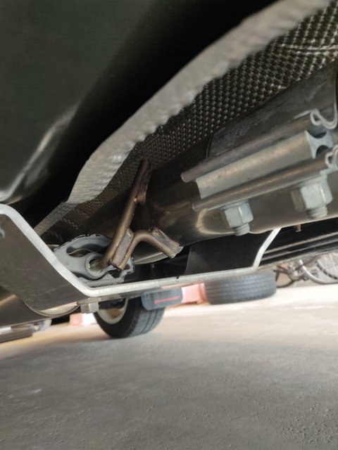

I recently installed the whoosh spec Thermal exhaust and noticed that the piping is actually resting on the crossmember that is mounts to, which is causing rattling. I suspect that this mounting point is supposed to hold the piping up off of the crossmember. Has anybody else noticed this? I'll try to get some pictures tonight.

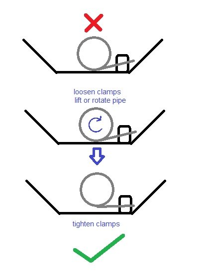

you gotta loosen the clamps and rotate the pipe up. Please see my museum worthy masterpiece below
Holy crap, quickest turn around ever! And an awesome sketch to go with it! I updated my post with a photo, looks like this should solve it. Thanks a bunch, I will try tweaking it this weekend.

edit: Just saw your picture, you may have the center brace on backwards. On my thermal exhaust, the exhaust hanger on the center brace is on the drivers side
The hanger is on the driver's side. That photo is looking towards the front of the car. Does that look wrong!?

the flat part of the hanger should be closest to the ground and the L- bent part should be facing up. I do remember seeing some thermal install videos having the hanger on the opposite side of what I had
