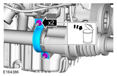

The manual will indicate which items should be replaced by the depicted 'trash can' emblem.
For example...
