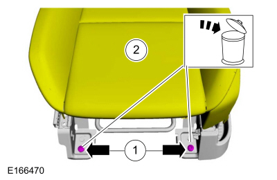

Front Seat
Removal
1. Depower the SRS .
Refer to: Supplemental Restraint System (SRS) Depowering and Repowering (501-20B Supplemental Restraint System, General Procedures).
2. NOTE: Follow the unique instruction or graphic for this step in the installation.
3. NOTE: Follow the unique instruction or graphic for this step in the installation.
4.
Installation
1. To install, reverse the removal procedure.
2. Torque : 35 Nm
3. Repower the SRS .

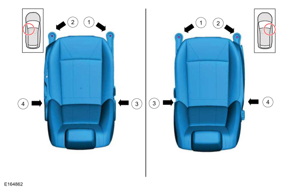

Front Seat
Removal
