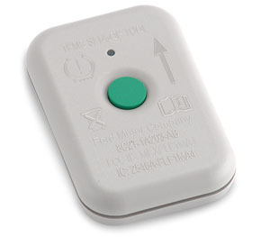

Concerning resetting the light manually, there is a procedure in the owner's manual, but it's kind of cumbersome and annoying because it involves letting about half of the air out of the tire after putting it into a programming mode.
Because of that, I bought the Ford TPMS reset tool. I have seen it called a TPMS 19, and have also seen this part number for it-
8C2Z-1A203-A
It looks like this-
Here is a helpful thread from the forum on how to use the tool, the tool is required after performing the sequence of pushing the ignition button and pressing the brake pedal. You put the car into a programming mode by that sequence of pressing the start button and pushing on the brake pedal. When it goes into programming mode you get a honk to tell you that it's there. Then you walk around and point the tool at each tire valve and press the button, you then get a honk to confirm that that sensor has been reset.I used the tool after I got new tires the last time and it worked well.

I've only replaced my tpms sensors once in 9+ years. Not being technically minded, I occasionally got a warning light, normally on a fwy. I bought the tool about 2yrs ago and recently had to get rid of the light. If you go through the sequence with the brake correctly, it will work as I found out. I surprised myself!

I had to replace the original sensors on our 2019 after only about 2 years. Neither the tool I have (shown above) nor the one at our Big O tire store could get them to respond.

I got the one off Amazon that will do Fords and GM cars. Works for me. It's in the car and I'll post something later on for the make etc.
