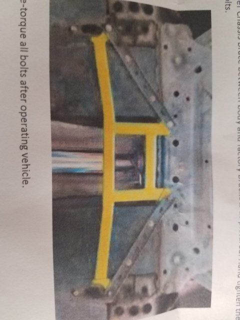

From the instructions give you an idea if what's going on here.
4 bolts R&R. Painless 10 minute install.
