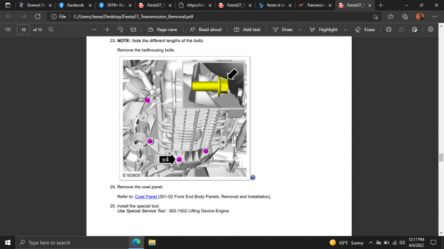

Sorry if this is discussed on the regular. I have everything almost out including the subframe but it seems the downpipe needs to be removed from the turbo. Is this true? I read people have done it without doing this. Is this possible?

No you don't need to pull the downpipe. I'm assuming you are referring to the one bolt that is right beside of the DP. You just back it out and leave it there.
