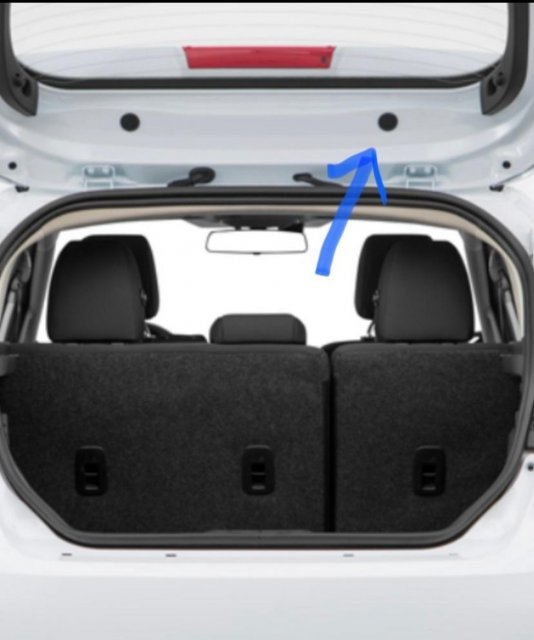

Noticed 1 of these was missing the other day. Haven't been able to find on parts site to replace. Any ideas what they might call it?
Arrow is pointing to like a rubber plug

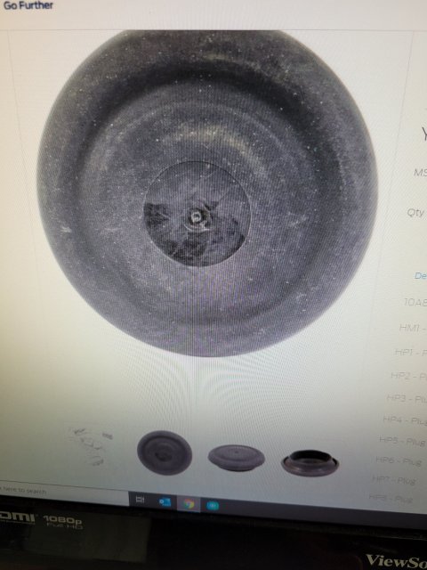

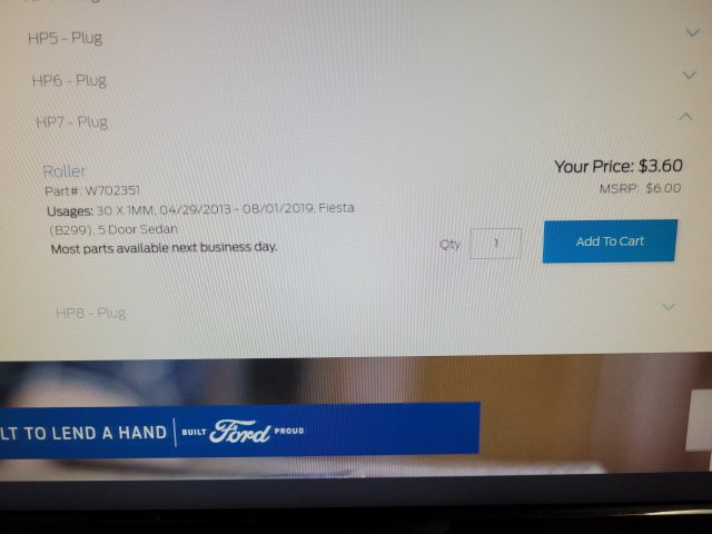

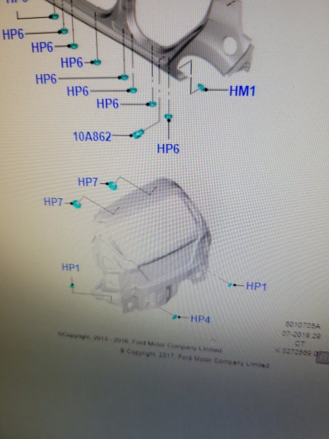

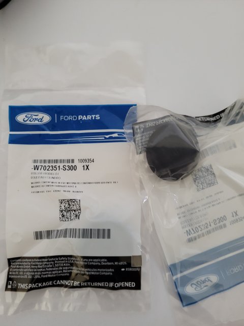

Wasn't home last night to check it out but the ocd finally found it. Looks like ford calls it a roller.
