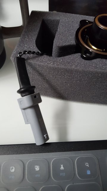

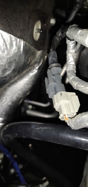

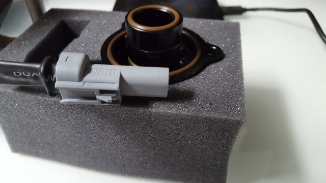

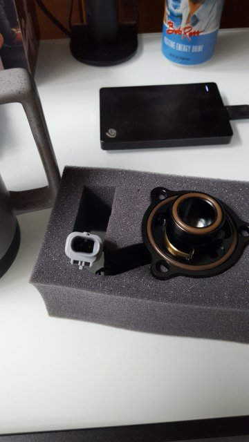

I have the plumb back, just opened it up to look and there is no blue anything on the connector, but I am not seeing any way that it could go backwards with the plug clip and alignment barb on the inside. Here are some pics of the connector on mine

oh sweet yours has a different plug. mine didnt have that little lump on one side, so it could fit in either way :|
glad they changed it! now i just wish i could find the car-side connector so I Could replace it without doing the whole harness
