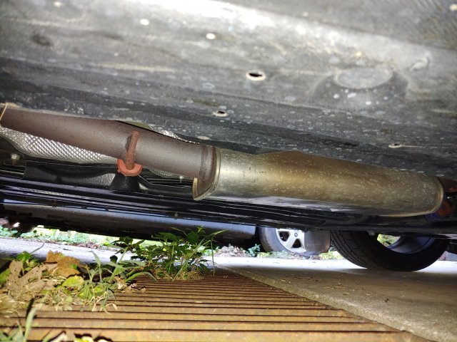

He made a post about how to identify modifications and took some pictures of his exhaust system. He has his factory resonator in place but the rear muffler section is just a straight pipe with a big single tip.

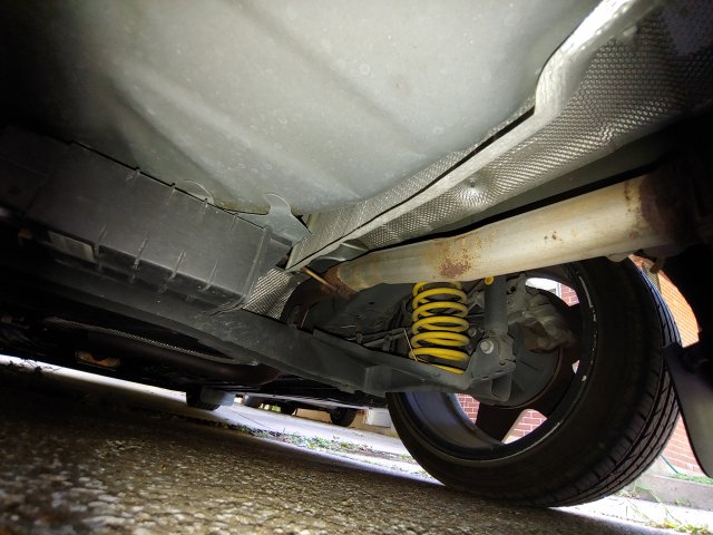

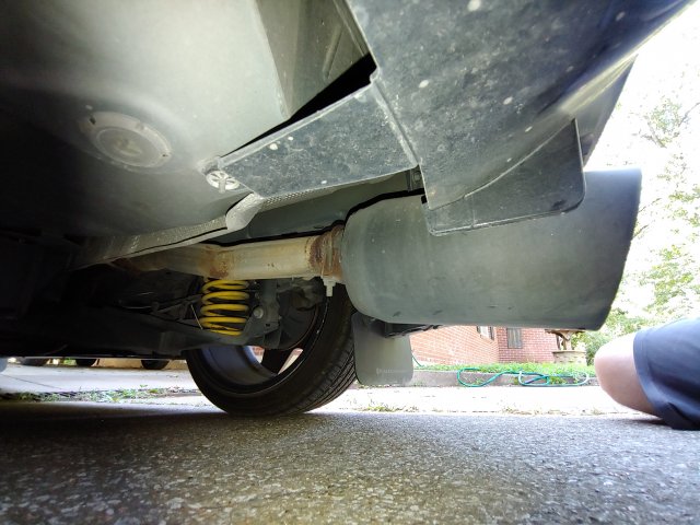

Take a pic of the rear muffler area to give us a visual if you can. If you’ve been muffler deleted, yeah it’s pretty obnoxious. If you have a straight through magnaflow muffler then the drone is probably getting to you. Your remediation path is reliant upon what’s in there now.
- does the sound only bother you at certain rpm’s? If so, what rpm?
- do you want stock-quiet, or just less-loud?
- what is your budget for this? Might be able to buy someone’s removed stock exhaust for cheap and have it welded back together.
Yea i posted them a while back but here's a few to show again. So just so i understand, the thing in the first pic is what, the resonator? So im guessing there's a resonator that goes just piping back to the Magnaflow tip that's on the last two pics? I think what Ford said is right but here are the pics. 20190730_164427.jpg 20190730_160838.jpg 20190730_160857.jpg 20190730_160913.jpg
As for the sound, im pretty sure i have some drone at around 3k, usually more when i fully let off the gas or accelerate hard. From what i have read that's a sound issue inside the car and isn't heard outside. Im more speaking of the general loudness of the exhaust, it's just pretty loud and isn't really my style.
It sounds ok and im sure a lot of people would like it but im more of a low key driver. I don't necessarily want the stock setup back on, just something a tad quieter. Also, will a different muffler actually change the sound or is that more of a piping and resonator thing?

Well you are a patient guy to put up with that bahavior. Anyway, i was looking at the pics i posted yesterday and saw a bolt on the piping behind the Magnaflow tip. Woudn't that suggest it's bolted on and not welded? I thought i saw somebody mention it looked like they welded it on after cutting off the muffler, but i wanted to be sure as that will likely alter the labor cost for a shop.
If they can just unbolt it and bolt on another, surely that's cheaper than having to cut through the exhaust line to get it off, and i'd rather have more than enough pipe than not enough. If i need to take another pic i can if that would help. .jpg

#19
Well, it looks like it was a bolt-on tip, I can't tell if thats just rust at the interface between the pipes or a total booger of a weld. That being said, they'll cut off pipe significantly further forward to fit a muffler, lots of mufflers are 18"-24" cases and have to fit in the muffler cavity up above the crimp-bent pipe in your pic.
