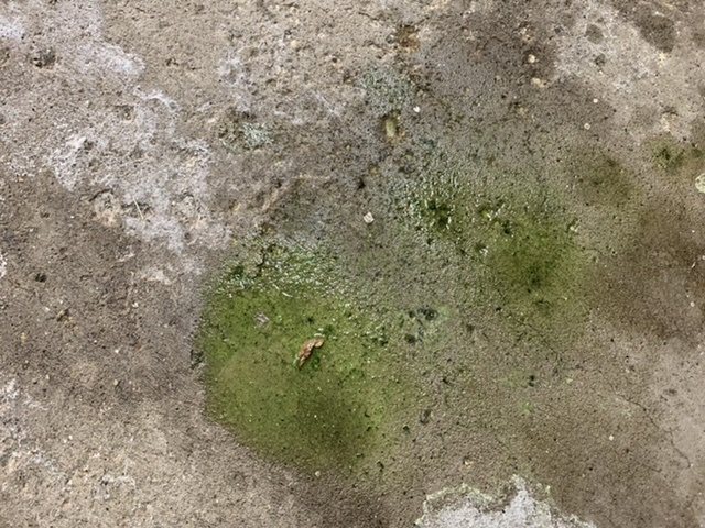

Went to inspect a bit closer and found the backside of the fan shroud had a small amount of moisture. Backed the car up and noticed this:
Only green liquid I’m aware of is refrigerant? This leads me to believe it might just be AC related?

Looks like a Pag oil/ compressor oil to me. I'd be making an Appt. If it's still under warranty. Look at the compressor hoses. I remember some of them being to close to other parts and rubbing through due to vibration.

Yup that's refrigerant. Happened to me when messing with the coolant tank. Haven't actually fixed it yet...

Took the car to a dealership near me. The tech, who I've worked with a few times before, took me into the garage to explain to him what happened and where the issue was. Fortunate because I got to see all the work performed and the readings off the Ford Diagnostic Tools. He inspected the entire engine area and system. Ran full diagnostics on the compressor and the fan. Everything appeared fine and we could not reproduce the system discharge. He did explain to me that the compressor does have a pressure valve that can activate if the PSI gets too high on the system. The system was pretty close to empty, so he refilled the AC system and rechecked the entire system. No leaks, no issues and the AC ran like a champ. His theory either:
  1. My full ECU and KAM reset caused a misread on the system pressure and it purged the lines to reduce pressure; or
  2. The pressure valve is bad and would need to be replaced, which would require the entire compressor to be replaced because its built in.
The plan is to leave it be and target the compressor for replacement if it reoccurs.
3,650
2,255
It's news to me that pressures in automobile A/C systems are directly controlled by computer now. In the past its all been mechanical. At most the ECU would be able to turn the compressor on/off based upon high/low side pressure switches or/and engine load; such as WOT.
It's possible that the only defective component is a refill/safety valve; releasing pressure when it shouldn't. Possible that the compressor wasn't shutoff and/or internal pressure, probably the high-side, got too high. A mechanically operated safety valve vented the system to prevent a literal explosion. As far as what might cause excessive pressure, could be a pressure switch, its wiring, compressor clutch or system blockage/restriction. Its coincidence with resetting the ECU and KAM I'd think were unrelated an pure coincidence. After changing my oil, started it up and my blower motor would not work for example. (just had to re-seat a relay)
