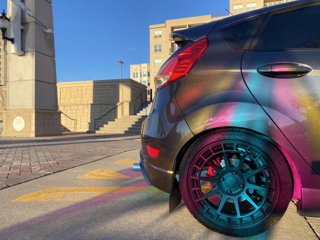

Enjoy the hot shots of my baby

I haven't seen very many if anyone running Freektune, on this platform at least. I have Stratified and have no complaints but I'm going to give Jason at Dizzy Tuning a shot here soon. Plenty of setups like yours, you'll be fine with stage 3 until you find the tuner you want. Also, I've been catted, then catless and then catted again on the stock turbo. You lost a little power, not much but some for sure. I personally don't mind the smell but I'm not going catless again until I swap turbos and by then my FiST won't see much road use anymore. If you have E85 close to you run and and don't look back. I love those wheels (y)(y)
