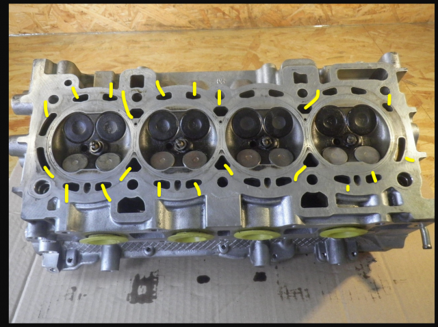

\I think the linchpin for me is... can the keeper escape... is there an oil passage way that allows it to escape to the bottom. I'm trying to find some diagrams.
Are some of the yellow marked openings for oil and some for coolant... seems big enough if there's an opening in the side off the valve area.
