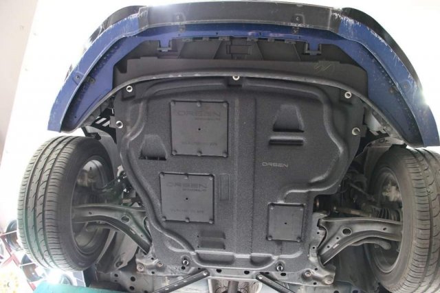

Interested in the Orsen Shield and what you had to do to get it on.
It's at customs right now so I don't have it yet but I'll let you all know how it fits. The pic I posted was something I found online.
I was interested in that one a few years back when I looked, but couldn't justify the price not knowing what I'd have to do to get it on. Hope it's simple. This one is attractive because of the vents and latches, which hopefully gives access to the oil filter and drain.

Orsen Shield - Car undercarriage protection shield
Radium Engineering Catch Can System - Fiesta ST
Will this shield fit with under car bracing? 2-point...4point and 6 point brace from any of the vendors? And not to mention certain charge pipes? The speculation game begins....
We shall see.
Mountune chassis brace is minimally invasive like a small unit āš”ļø
