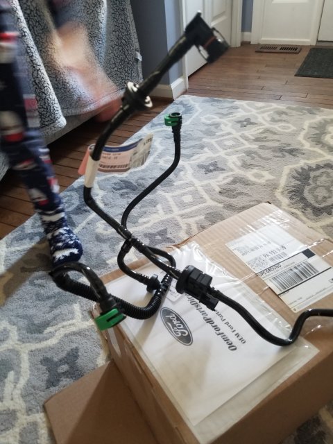

This beats a pic of 1552 / fancy schmancy rims any day....LOL! As per previous, I bought the valve from Rock, but it will/would be a project to retrofit. This spiderweb has to come from Ford - about $150 shipped.

Its obvious that I am no mechanic, it's a fact - no multimeter. However, I spent 10 years owning and operating a parts store, and another 10 as a Regional rep for aftermarket parts. What I can do is use past experience to posit a current solution. My butt dyno tells me this is a vacuum related issue, and all the dance steps with the nozzle will have little effect.
I have this elaborate process when I fill up:
1. Put the nozzle in and wait 5seconds before turning on the pump
2. Wait 30 seconds after the pump clicks off before removing the nozzle.
3. Go drive on the highway or somewhere on 6th gear for a couple minutes.
While the waiting game with the pump doesn't cure the problem, I feel like it makes the car less likely to stall.
PS I have replaced the purge valve and it didn't fix it.
Link?
Yes, I'm lazy:ROFLMAO:
Edit: I stopped being lazy temporarily and found this
https://whooshmotorsports.com/colle...-to-convert-2016-fiesta-st-to-2014-2015-specs
Is this the right part to fix the purge valve issue?
