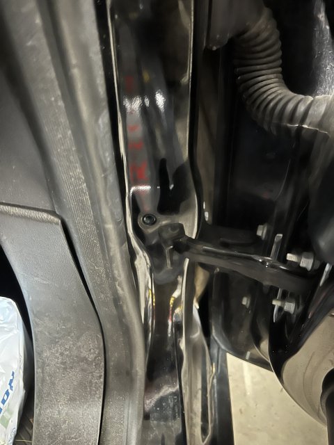

I’m replacing the passenger side door seal today. I’ll keep this thread updated as to whether they fix the issue.
I’m using weatherstripping adhesive for the lower part of the seal. The seals are actually pretty easy to change. I only have to unbolt one screw for some little thing that holds the door on. 607BCE4C-64AC-4946-8189-B61DCD062466.jpeg
I’m using weatherstripping adhesive for the lower part of the seal. The seals are actually pretty easy to change. I only have to unbolt one screw for some little thing that holds the door on. View attachment 55061
Well, sadly the new door seal has not solved my problem. I think at this point I’m resigned to just having towels stuffed between the seat and the side of the car to catch the water before it hits my carpet

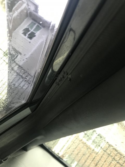

what about the strips on the roof? I know other cars Hondas that have had issues with water and those top roof mouldings and it would get in near the front seatbelt.
The doors themselves drain water down the bottom which ends up getting sills wet, not sure why it would be getting further in the car though. The exterior moulding at the base of the window could be letting more in than it should? Maybe check the little door drains too just for the hell of it.
325
500
Raleigh, NC, USA

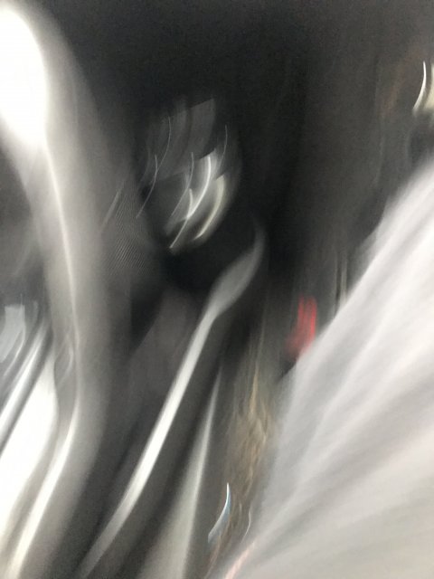

Caught it seeping. Again, only when parked on a slight angle. Little splotch on the mat where it had pooled up about the size of a quarter. That picture came out incredibly blurry though. :cool:
