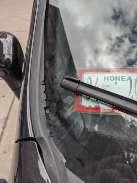

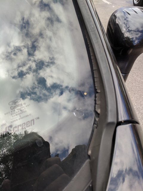

it's looking a bit raggedy on Pimienta, my 2014 Tux black ST. Does this look like there's still some wear left in them? Easy to replace? Thank you for your help
Those are really easy to install. I replaced mine in 2018.
Part numbers are:
BE8Z-5403137-A (Windshield Molding, LEFT)
BE8Z-5403136-A (Windshield Molding, RIGHT)
They were $21.46 at Tasca Parts two years ago.

Though I suspect that that hot mess just needs to be replaced.

Sucks that the price has doubled in a couple of years.
When replacing these is there anything else to do aside from cleaning the area that is covered up?
Yeah the price is high now. In terms of prepping, you'll just need to brush and clean the area from the built up of dirt. Nothing else to do.
