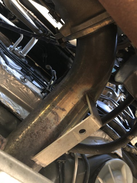

What brand Downpipe is this?
11,973
8,408
Saint Pauly
It's a catless DP....explain s the inefficiency code of p0420. Need to see if it has a de-fouler on the downstream O2.
I
8
Independence, KY, USA
It does not. I’ll be ordering one tonight. Or maybe just get an IC and go stage 3 where the code is just turned off lol

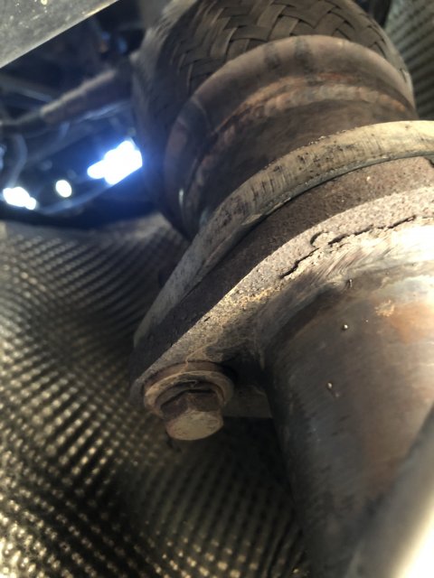

Is that a shadow or a cracked weld on that second picture?

only Time will tell ! I’ll check in the morning it’s almost 2am. My 3 year old decided to nap instead of sleep 😢

Surface Corrosion....I got $5 on it.
There is corrosion there, but i shouldbt be creeping under the weld. It looks like a gap. Vibration and thermal expansion/ contraction will break under a bad weld

I think it's the "Chrome" Finish coming off due to heat.
