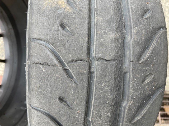

Just FYI for those running the RT660s, its a known issue where the thread face is delaminating from its core on some of these under heavy braking. This is a new pair of fronts I put on for Packwood. Dual drivers, 100 deg weather, fast course (with 3 heavy braking zones, 2 coming down from 3rd gear). Total of 14 runs...
Forgot to add, the 1st pair I got did not ever show this issue, with 100+ runs on them. Also the 3rd pair I put on to replace these for Tour, appear fine after 12 runs.
