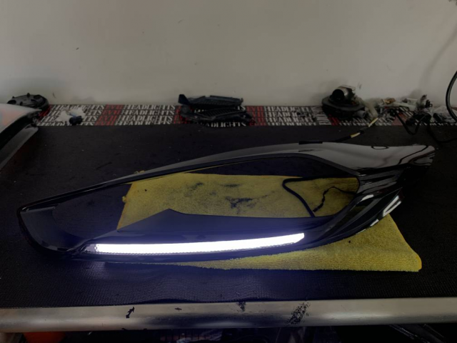

Yes, they have a very similar led strip for the DRL. You just move one wire and you can use parking lights setting to illuminate just them. Do a web search for "fiesta european headlights" (nevermind: found a pic, not my car but look the same on mine, I obviously have a magnetic car too), they are an exact replica of the Ford OEM ones so they are just silver internally and the LED DRL strip doesn't look like a single fluorescent light like your pic but the shape/location of the LED strip is the same. They do use an H7 bulb for the low beam and the Katana H7 LED is about $47 on Amazon and is fantastic output, the TechMax in H7 just isn't the same in a projector (vs. reflector).

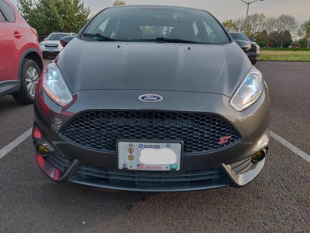

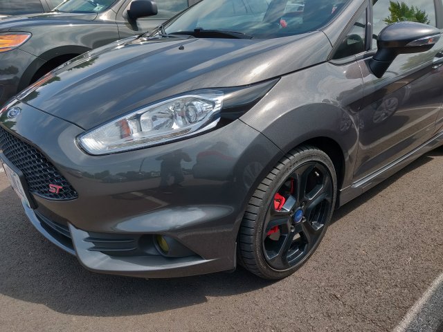

Some pics of mine. First pic was after I added the corner blackouts:
