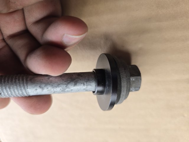

Well I'm glad I got the centering kit. My axle was just ever so slightly tweaked. I do wish the collars on the kit were a bit longer it would make installation easier
