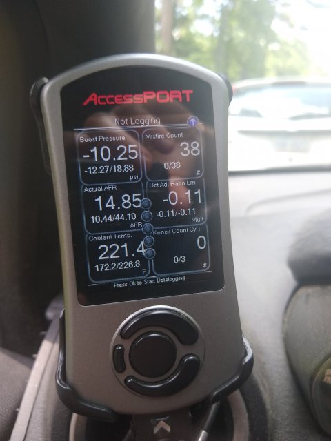

Do y'all think this is too many misfires for a 20 mile drive on mostly highway? I was monitoring misfires because I have some other issues rn.

idk about misfires, but I never get more than 1 knock event. I monitor on the 3rd cylinder. I think I've read somewhere that the 3rd one is more likely to knock. It happens early in the drive (first 10min?) but never again until the engine is cold.
