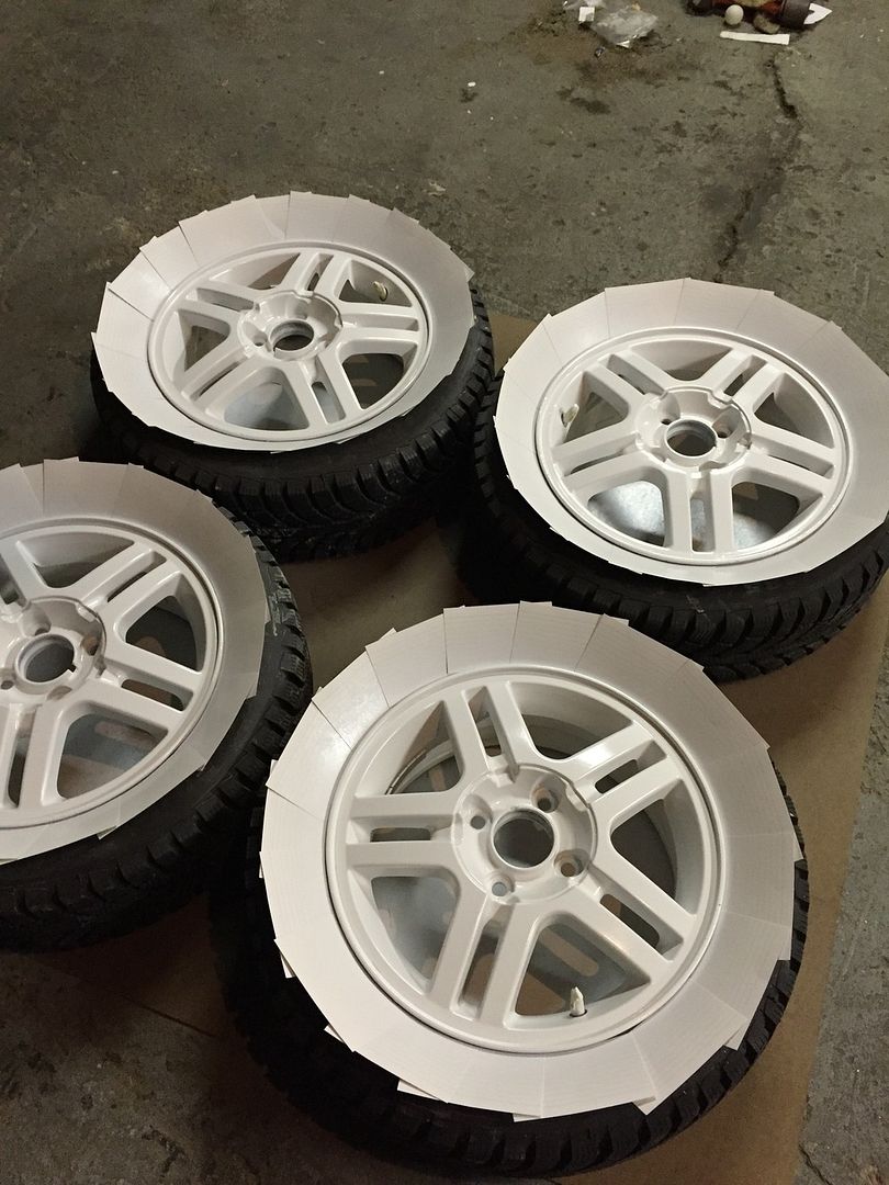

I think vinyl pin stripes are going to be your best bet for something like this. I've 3m stuff to red stripe old vw grills in the past and it's worked well. A little heat does wonders to make tight bends. Or you could paint them red, pin stripe your design, paint them black and then pull the pinstriping back to reveal the red first layer.
Also, just a quick tip, if you're painting your wheels with the tires on stick index cards in between the lip of the wheel and tire to mask them off. Much easier than trying to mask off the tire with tape!

Did you blast them or strip the original paint? (Or even paint over the original paint?) Looks pretty good. Not sure I have the patience for using paint stripper, but also don't have money/facilities to blast them...
