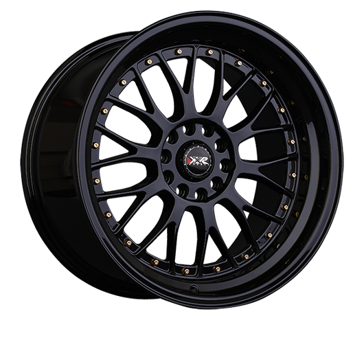

so let's pretend i get 4x108 to 4x100 adapters that are 1.25" thick. could rolling fenders and using slightly aggressive camber be enough to give it a good look? wheel specs would be 17x7 +38 offset.
Really just set on these wheels but if its not meant to be its not meant to be...
Maybe. More work than I'd be willing to do, but it might look good. Hard to say.

Aren't those XXR521s you pictured above DOUBLE drilled in BOTH 4x108 AND 4x100??
(Or aren't those the wheels you want?)
XR650R
2,616
3,028
Eerie
Maybe if you ask them, they can do you a set in 108.

Look around. XXR wheels do offer 4x108 in a lot of popular wheels.
I myself have a set of 17x7.5 XXR 521s.

They are drilled 4x100 and 4x114.3 =/
I cannot stand the way double drilled looks to begin with, but to go through the bother/hassle/etc. of using adapters in order to put double drilled wheels on my car, nah, NO THANKS (but that's just me). [wink]
