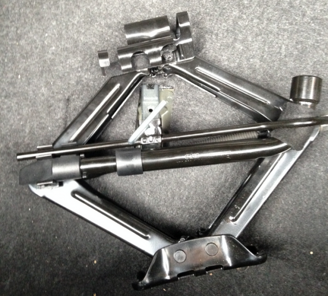

P.S. - Here's a picture of the scissor jack that comes with the car in it's original location/orientation. It was in there a very specific way so I took a picture in order to be able to get it back the same way. Figured one of you might be able to benefit from this in the same way.
Thanks for posting this.
Anyone have a photo of it installed? Dealer removed and never did put it back right. Another issue is, that plastic filler-neck (not photographed) is cracked-up. Is this common or did they manage to do that too?
