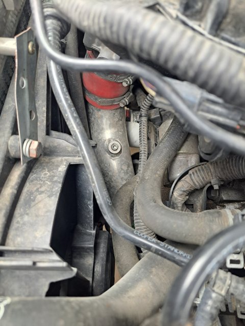

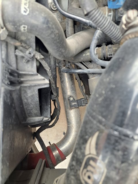

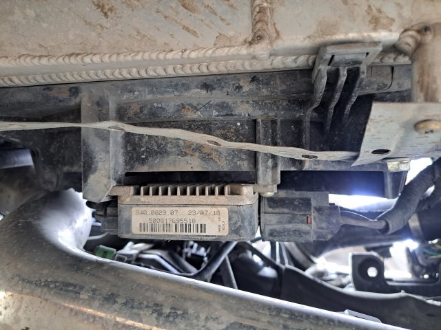

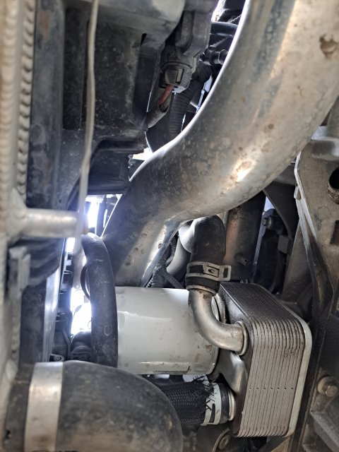

I'll one up everyone, I have the eBay radiator, boomba intake and throttle body spacers, FL-400S, and the whoosh cold side pipe installed. It's a super tight fit but its doable.
GeT Pics if you can...I'm curious to see how close.[driving]
