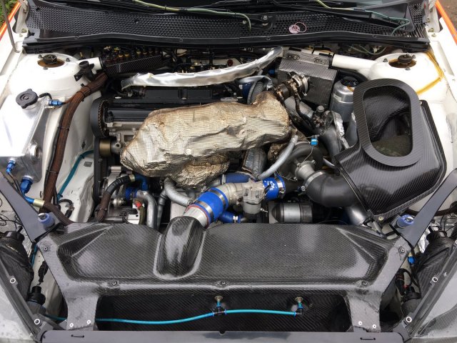

Use this Msport heatshield off Colin Mcrae's Focus as inspiration, doesn't have to look pretty, just has to work. [wrenchin]
