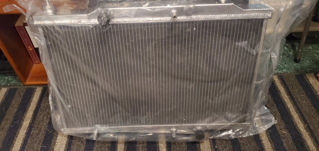

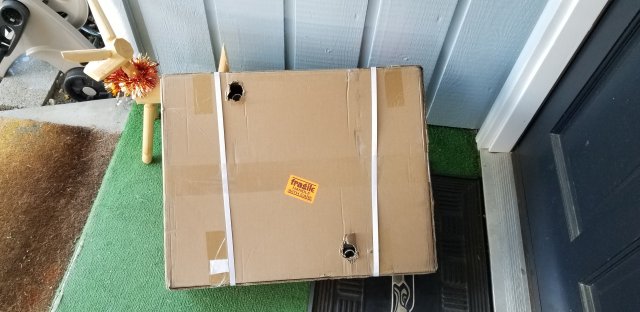

I showed my Wife the picture and she agreed very poor packaging. My brother worked at UPS as a loader for a few years over 400 packages per hour. If a package can't survive being thrown off your house the packaging is not good enough. You can't just shove shit in a box that is unacceptable.

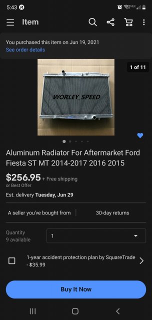

If you look at the picture from the one someone ordered from eBay it has caps over the upper and lower radiator hose location.
