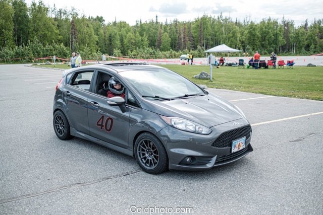

If you want wide tires, may I suggest 225/45R15?
Pros:
-wide tire
-bonus 0.25 inch lowering without compromising suspension geometry
-no rubbing, even with ~1 inch or more of lowering (I've tried Swift and am lowered even more on coils)
-smaller lighter wheels (I love the Team Dynamics Pro Race 1.2 in 15x8")
-cheaper tires
Cons:
-no big wheel on small car look
-have to buy wheels
-slightly less clearance
-your speedo says you'll be going 70 mph, but you'll only be going 68.5 mph (link to comparison page- you'll have to re-enter sizes)
Pros:
-wide tire
-cheaper tires
Cons:
-have to buy wheels

The only other 'con' is that if you do not lower the car with this setup, and retain the factory ride height, the wheel/fender gap is really noticeable as compared to taller setups, due to the shortness of it's overall diameter. (IF anyone cares about that at all.)
Lowered, even a little bit, and it looks GREAT (especially with the Pro Race 1.2s, and their slightly convex spokes). [wink] [thumb]

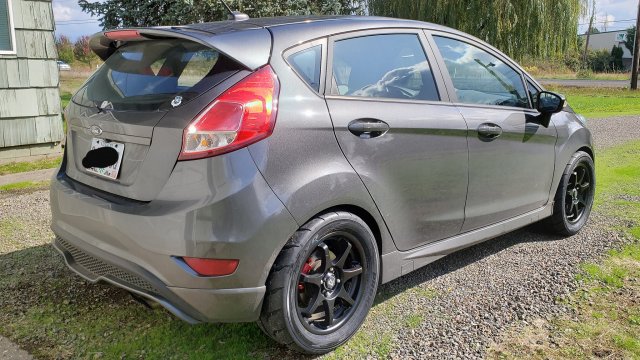

I have 225/45/16 Z3s on my 16x8 +38 rpf1 wheels and had no rubbing at all -2 front camber and very slight rubbing -3 front camber. My ride height is close to stock but my spring rates are stiffer Swift 8/6k

I'm like an inch lower than stock on 225/45/16 R888R's with 16x8 dekagrams and 5mm spacers to clear my BBK, and I've totally rubbed through my fender liner where it touches the fender, and I've bent my fender twice now lol. That's with 7k front and 5k rear springs as well, so much stiffer than oem.
I think it'd be better if I didn't have the 5mm spacer, but it is what it is. I think 215/45/16 is the perfect size on a fiesta with 16x8's
