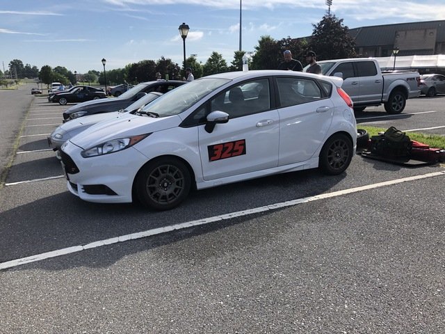

If you don't have a big brake kit, yes. They will fit. I am running them now and will post an image tomorrow morning.

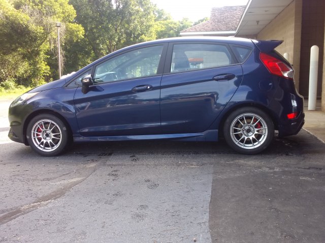

Mine on O.Z. Ultraleggera 15X7 with 205/50 R15 Dunlop direzza star spec tires. Stock ST coils on Koni Sport dampers. No fit issues with this setup!
