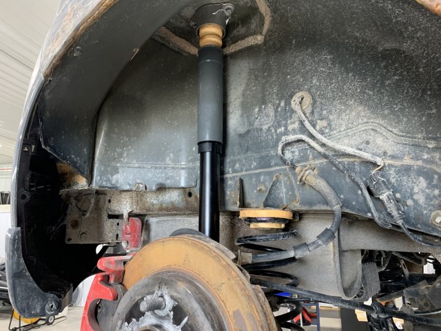

I purchased stock 2019 springs from @Dialcaliper and mounted them at the rear with the stock 2014 dampers. (Here)
Change in ride, almost nothing. What did change was the clunking from the worn bushings was gone, but I could not detect the difference in the rear.

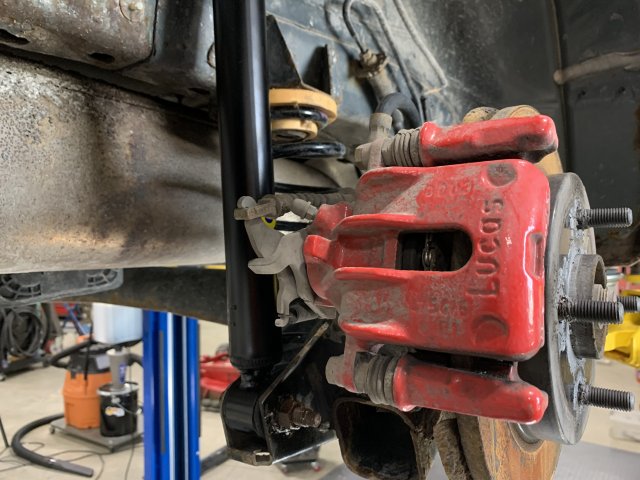

Next up, I bought the OEM 2019 dampers and installed them with the stock OEM foam spring perches.

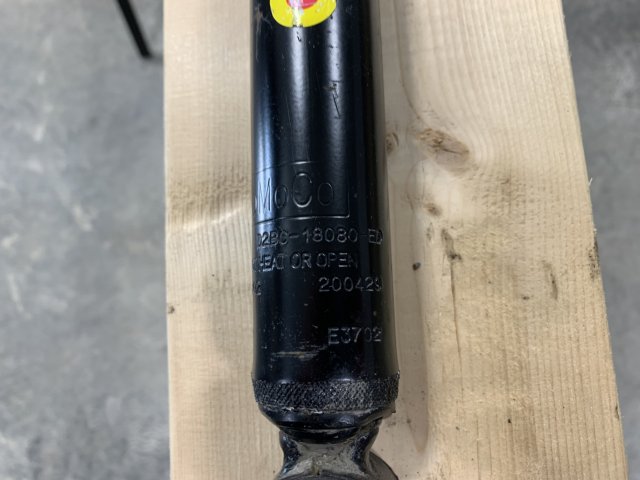

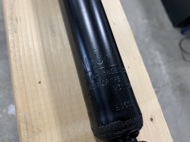

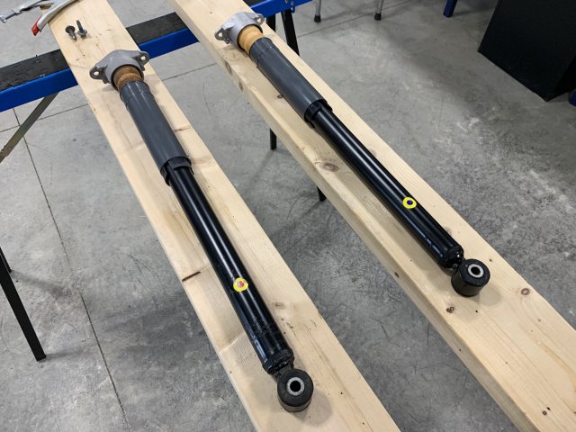

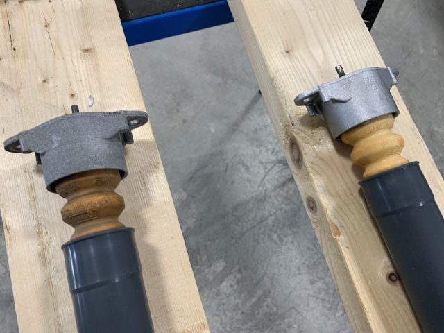

Here are some photos comparing the 2014 and 2019 dampers.
If you notice, the two different colors. Red & yellow indicate 2014 dampers. Blue & yellow indicate 2019 dampers. Anyone else can confirm/infirm this?
Serial numbers.
The left dampers have 14500 kms (9k miles). So I would consider them broken in.
View from the back.
Now I have the full 2019 rear setup (springs + dampers). Since then, I have not been able to feel a difference for the back end. It's still as ''crashy'' and harsh as the 2014 rear setup (good to know).
