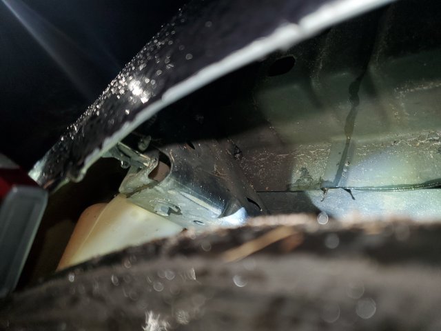

I am shocked that those do not rub everywhere, ALL of the time, no matter how much cutting, pulling, etc., is done.
They are almost 25" tall, and have a 9.2" section width, albeit only a 7.7" actual tread width, but on 40 ET wheels!!

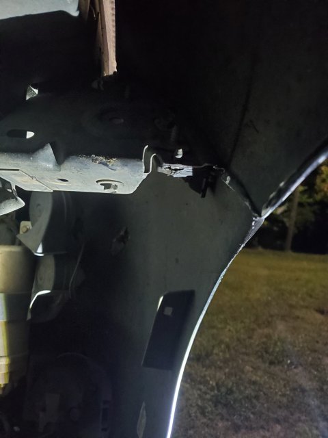

You can kinda see the support I cut out. When the fender lip was stock and that bracket piece was there yes they always rubbed. But now the thing is that flat piece under the headlight contacts sometimes. It's really not bad, not perfect, some may say not ideal, but it's fine for me. I wanted fat inexpensive tires.
Other pic inside passenger fender, forgot to get before shot.
