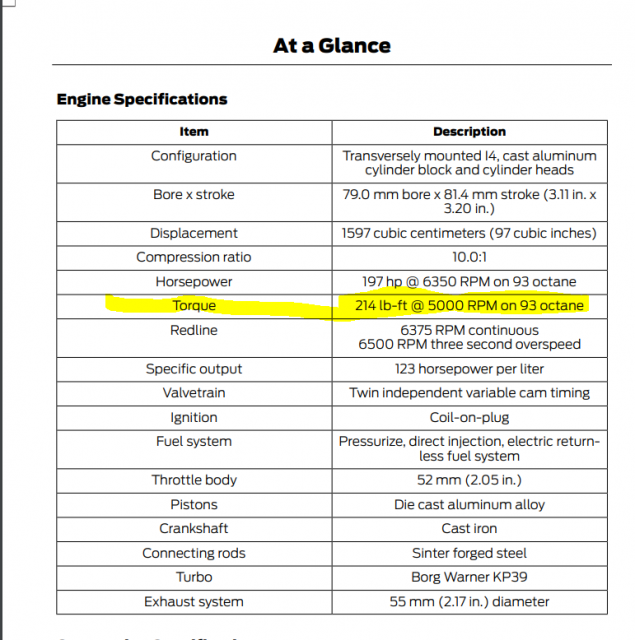

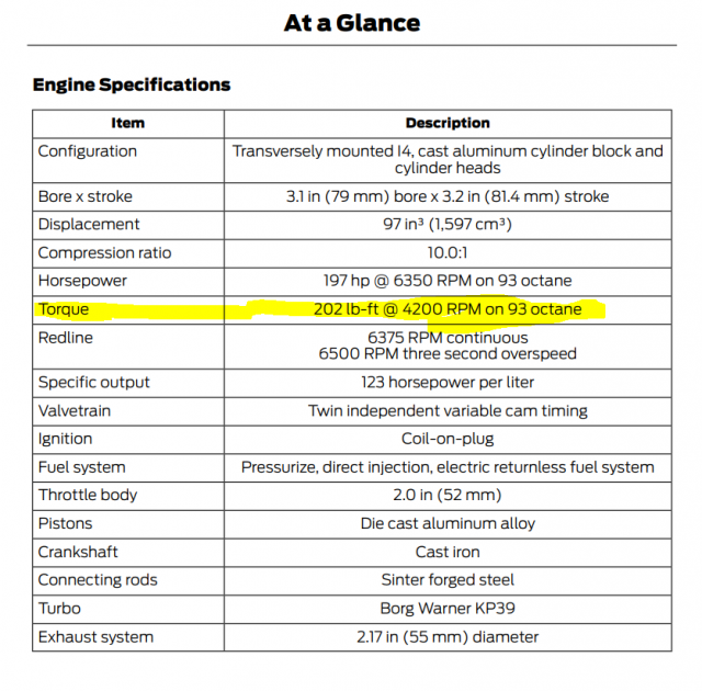

Headline says it all. I got this information out of the supplemental manuals.
2014: 214 lb-ft @ 5000 RPM on 93 octane
2019: 202 lb-ft @ 4200 RPM on 93 octane
Are these really different? Or did they just stop listing the "boost" effects come 2015?

IIRC the advertised power was with the overboost.. I could be wrong. I'd like to see a pic of what you're seeing though.

Weird, maybe the overboost is the reason why? Im curious to know the answer. And why would the hp be the same with the only difference being torque?
Thanks for posting those!

Horsepower is a function of RPM and Torque. Note, at 5250 RPM the horsepower will always match the torque produced at that engine speed. As a result if you have a torque curve you can calculate the horsepower at any engine speed covered by that torque curve. So, a 2014 engine with a torque peak of 214 ft.lbs. at 5000 RPM will produce horsepower = 214 x (5000 / 5250). For the 2019 engine the HP at peak torque will be a much lower number = 202 x (4250 / 5250).
Since both engines have 197 HP listed as maximum it's rather obvious that the 2014 engine had the torque drop off rather quickly between 5000 and 5250 RPM and the 2019 engine produces more torque that the 2014 engine somewhere past 5250 RPM.
I also suspect the differences are due to Ford installing a different "Tune" for the two engines in question.

Did either of you go to the PDF? Both are for mk7 Fiesta STs - both refer to the i4 motor.

So looking more into this. It's only the 2014 listed at those numbers. 2015,16,17,18,19 all have the lower numbers as well. Very interesting.
