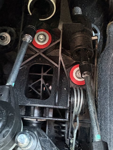

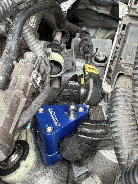

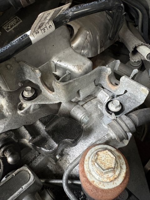

Alright so a Nov 2025 update:
So far I installed the following:
Swave front and rear strut braces
Whoosh hot and cold side charge pipes
Afe dry mesh air filter
Whoosh silicon intake tube
Whoosh crossover pipe
Whoosh shifter bushings both ends
Whoosh short throw shifter block
Sparco rear tow strap
TB torsion beam bar
And i flushed the brake fluid with Motul 600
I have a ton of other parts coming in and more in my liviing room, im waiting to get on my friends lift to knock it all out.
