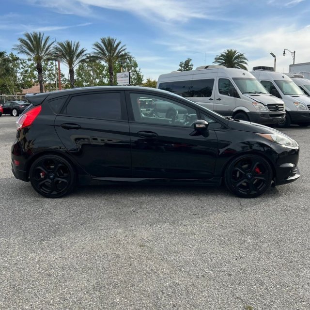

Hey all, I recently got myself into a black 2018 FiST (109k) and have been doing a lot of reading up here which has been great.
I’m coming from a Hyundai Kona N which was an absolute blast but wanted to cut my payment in half and get back to something more raw. A few cars back I had a 14 FoST ST3 so I’m generally familiar with the STs but really didn’t know a great deal about the FiST at that time. I wish I had. Once I started looking for a cheap, fun, manual this went straight to the top of my list.
The mods I’ve discovered are in my sig. The car looks to be Stage 2-ish and handles really well. It has some quality parts but the car is beat up a decent amount. But for $9k in So Cal I felt it was the right deal and leaves room in the budget for some maintenance.

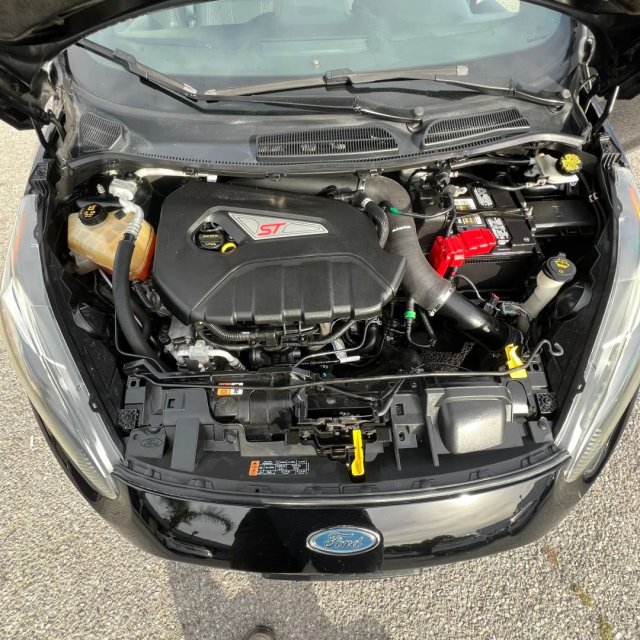

  • a light suspension clunk at low speeds -- appears to be the radiator which has lots of play

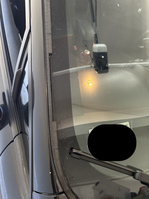

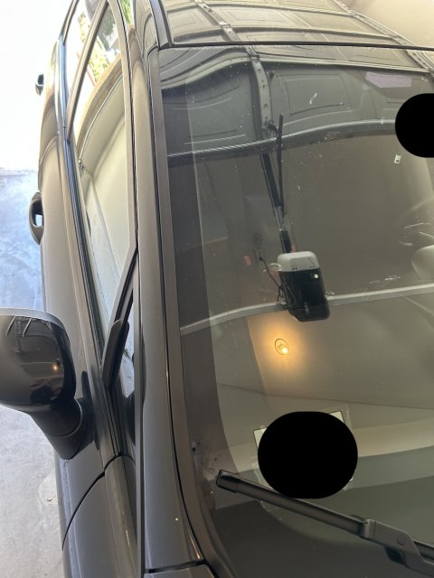

  • Windshield side rubber strips have deteriorated -- replaced!

The windshield rubber strips are easy to replace. There are threads on here about it. There is a little trick to getting them on without damaging the tabs. The parts are AE8Z-5403136-A (passenger side) and AE8Z-5403137-B (driver side). Used to be cheaper but have gotten pricey. You can use parts.ford.com to order them for pickup at your local Ford dealer.

  2. Windshield molding - I replaced these with this offbrand $35 set (https://www.amazon.com/dp/B0D2XSHFH1?ref=ppx_yo2ov_dt_b_fed_asin_title). The tracks they sit in were a little banged up but these feel in there solid and should hold.
  3. Front rattle at low speeds - From the top of the bay, after jigglying everything I could touch it was super obvious that my radiator is the culprit. Before I take off the bumper I'm going watch some vids to see what I'm dealing with but this is almost certainly the noise I'm hearing as it's metal on metal.
