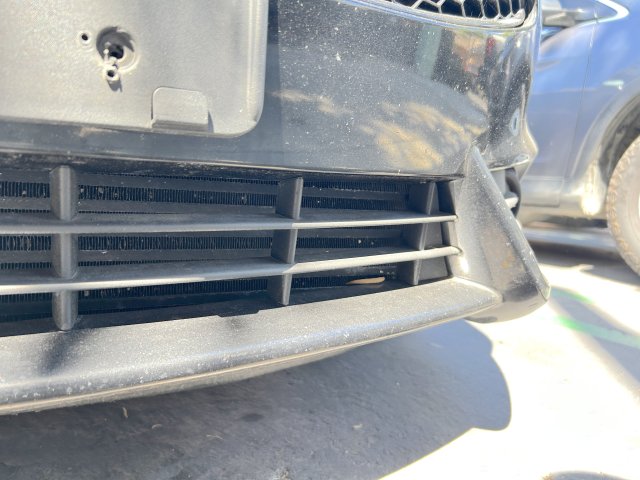

Hey all, I recently got myself into a black 2018 FiST (109k) and have been doing a lot of reading up here which has been great.
I’m coming from a Hyundai Kona N which was an absolute blast but wanted to cut my payment in half and get back to something more raw. A few cars back I had a 14 FoST ST3 so I’m generally familiar with the STs but really didn’t know a great deal about the FiST at that time. I wish I had. Once I started looking for a cheap, fun, manual this went straight to the top of my list.
The mods I’ve discovered are in my sig. The car looks to be Stage 2-ish and handles really well. It has some quality parts but the car is beat up a decent amount. But for $9k in So Cal I felt it was the right deal and leaves room in the budget for some maintenance.
The things I want to fix first:
  • check the tune
  • a light suspension clunk at low speeds
  • backup camera isn’t engaging when I go in reverse
  • TPMS sensor alert
  • Windshield side rubber strips have deteriorated
I’m in Orange County CA and Carfax shows this as a CA car, last in the LA area. If anyone knows the previous owner (or the car) I’d love any insights.
