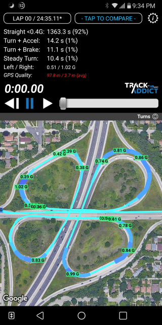

They were rather sticky tires in the summer, not greasy at all. I could not get them 'break traction' despite my best efforts. I was nervous to go beyond the numbers you see on the screenshot below.

They were rather sticky tires in the summer, not greasy at all. I could not get them 'break traction' despite my best efforts. I was nervous to go beyond the numbers you see on the screenshot below.[/QUOTE]
That's amazing, .99 g's, isn't that? Is anyone going past 1 g's on streetable or a/s tires?
That's amazing, .99 g's, isn't that? Is anyone going past 1 g's on streetable or a/s tires?[/QUOTE]
It certainly felt amazing as they were newly paved and they bank inwards. You have to allow for some error on those readings. The Qstarz BT-Q818XT 10Hz GPS receiver is good for the price but I don't think it's considered high end.
It certainly felt amazing as they were newly paved and they bank inwards. You have to allow for some error on those readings. The Qstarz BT-Q818XT 10Hz GPS receiver is good for the price but I don't think it's considered high end.[/QUOTE]
I've gone 1.4 g's on RT660's on the street, they are "streetable".....you just wont get alot of life out of them. I've also been 1+ g's on RSRR's, and Toyo r888r's on the street, it took more effort tho, but they definitely last longer.
