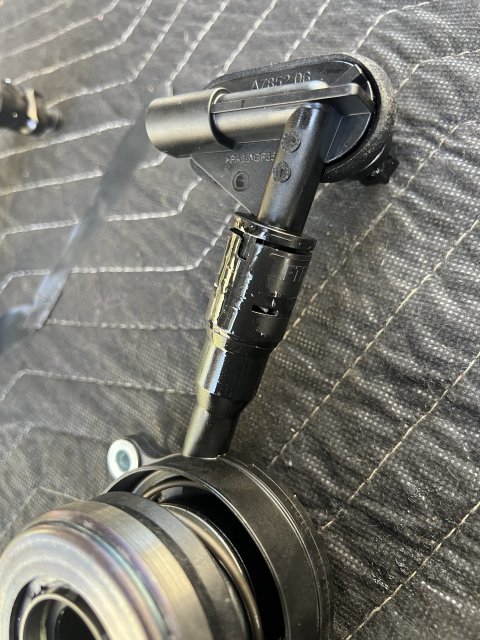

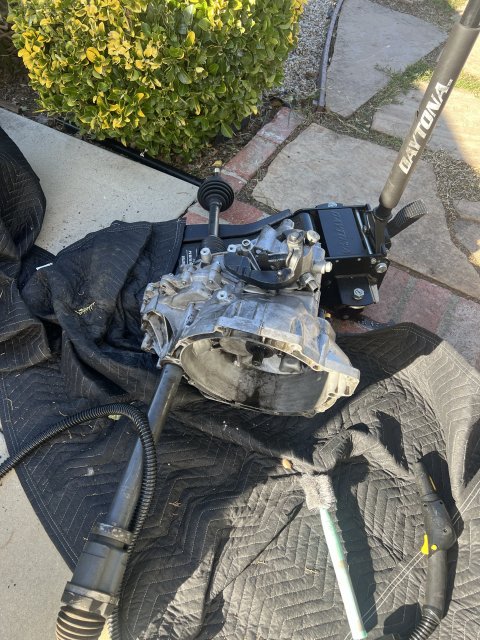

Now at 72,000 miles I have recently had a new issue that began to show as a what i thought was a clutch master failure and was only where the car was driven hard the clutch would sink or not return fully… I proceeded to replace the clutch master and rebelas the system. I did buy a new slave but it seemed to hold vacume pressure and showed no leaks. One week later driving hard the clutch began to slip and when pulled over at work the slave was leaking in the clutch housing. I spent the next morning pulling out the trans and decided to order a new woosh high pressure clutch setup, and just for extra I got a new oem slave and the oem master line along with a cool works shifter I was eyeballing….
a week of driving and all seemed great. A decent amount of breakin driving and I hit the touge for some therapy… I have a rear tire rub I’m working on ( inside back bracket to bumper I’m working on) and clutch began to sink again.

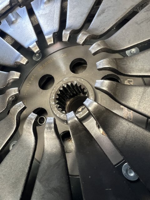

I reached out to Ron and again verified the clutch was correctly placed ( clutch says gearbox on it so it clear what side is out) checked the master found a small seeping connection and fixed it, but also found the joint on the slave was leaking and fixed this. Vacune pressure showed perfect over night so I cleaned it all up and got it back together. On week of driving and started a therapy run through little Tujunga cyn and got to the top and again the clutch failed to return.. I was able to pump it up but by the time I got to my work that night the brake fluid was everywhere under the car. Next morning I limped it home… I notice a few patterns. It’s not the clutch itself but could the brake vacune cause this? I literally felt it under my foot pull away in a right turn. Could the heat from the brake fluid cause this… could the traction or ABs system cause this? I usually turn it off but I know it still has function…

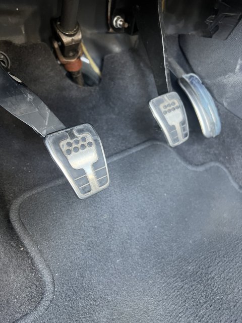

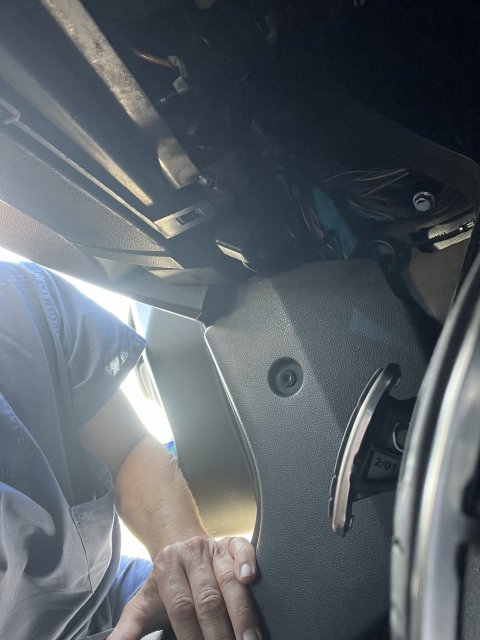

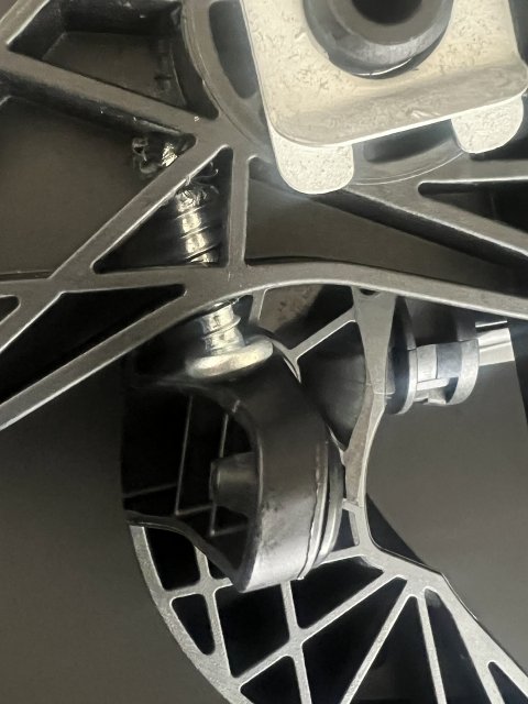

I went over some of the symptoms and came up with a new thought on my issue today… anyone willing to chime in on this. I think it’s the issue with all fiesta st slave failures…
Ok, soooo if you look at your clutch pedal it sits about the same hight as the brake pedal right!
Ohh it’s higher than when you first bought it???
well it should not be….

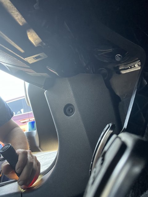

my clutch master body however is very worn and may be missing a rubber stop or something and sits a half inch higher than all the other pedals I looked at on the dealer lot today…
Just dawned on me this may be the issue…
I realized this can cause the slave to over retract. This may cause a vacuum in the slave so when turning right,( gravity toward the trans), the vacuum and gravity gives just enough pressure to suck the slave past the seal under repeated turning and clutch release…. Bam it gives out not from pressure but because the vacuum from the master….
see my photos.
I think the solution is not just a master replacement but a full pedal replacement!!!!
I will test tomorrow on a run to see if I get the pedal drop or no return.
As a quick fix for now I put a clear rubber grommet around the clutch switch that activates the starter. It’s sticky on the back with the hollow hole in the middle… it seems to temporarily hold in place…. Let’s see till I make a more positive stop or buy a new pedal…
Still may seporate the clutch from the brakes because I really cook the fluid often and it will avoid contamination of the clutch system…
many thoughts on any of this….

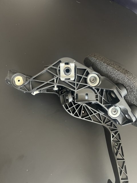

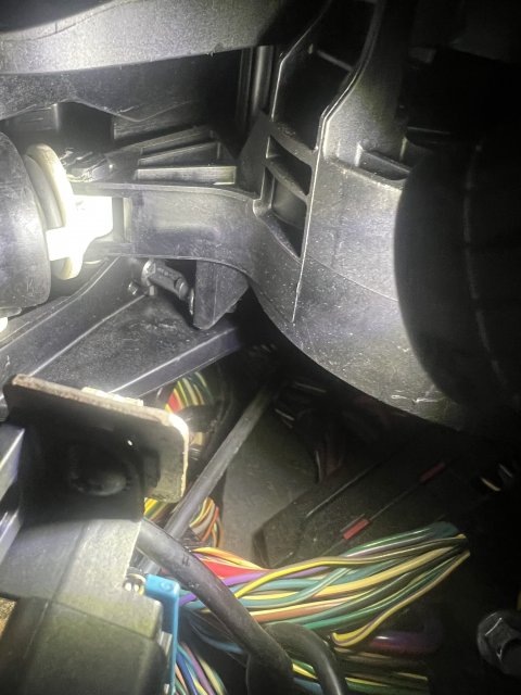

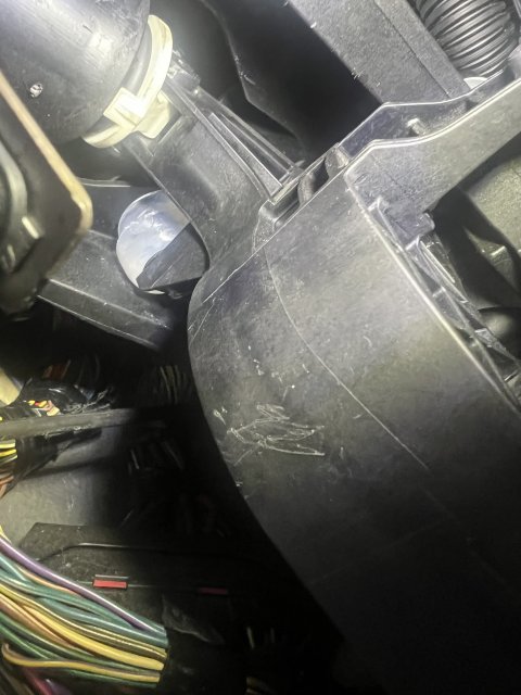

Just wanted to follow up with this as I’m still fighting the issue and have changed every part including the clutch and flywheel master cylinder 2x full pedal and master, slave cylinder3 x with still the same results. I have pulled my trans out 4 x. And changed the entire lines and even dissected the slave and clutch master.. on a side not one of the slave cylinder failed not at the bearing but at the joint befor it exits the trans. The only fix that prevents the slave from failing is a set screw I placed to prevent the pedal from overextending. Ford does not have a positive stop on the pedal and if it goes past the point of the relief hole in the master it over suctions the slave past it’s seals and the slave will start to leak… this is a bandage solution and I believe my situation is not unique but is related to the brake system. My next step will be separating the clutch from brakes
Se the photo to see my fix that is not ideal because I get in every morning
I drilled the master housing right at the point where a tab on the pedal becomes even with the housing… I used a simple machin screw and a drill and marked a perfect aligning line so my screw sits flat when contacted. I set it so it just touch then quarter turn out. You thread pitch will determine how much you turn back out but the pedal should end up near even with the brake. Mine was a half inch above and way past the relief valve.

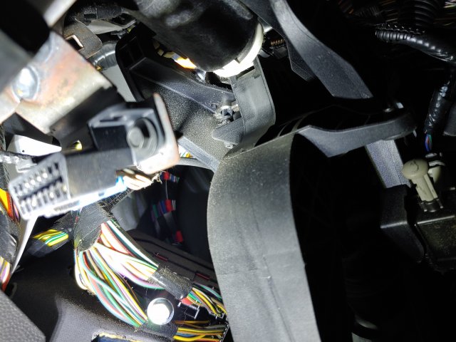

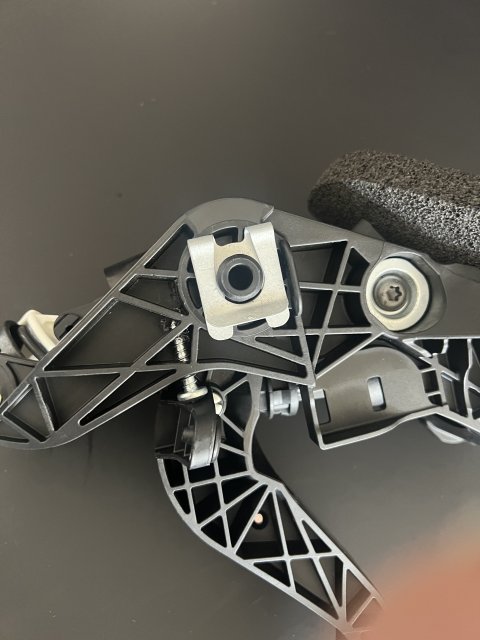

I happened to be sweeping my car out and checked out some of the things you're seeing, for comparison purposes. The clutch pedal in my 2016 is not even with the brake; a little higher. Only spent a minute looking at it and didn't see where the stop was. (hidden beyond the fulcrum) But attached an image of what I suspect is the upper clutch pedal position switch.
