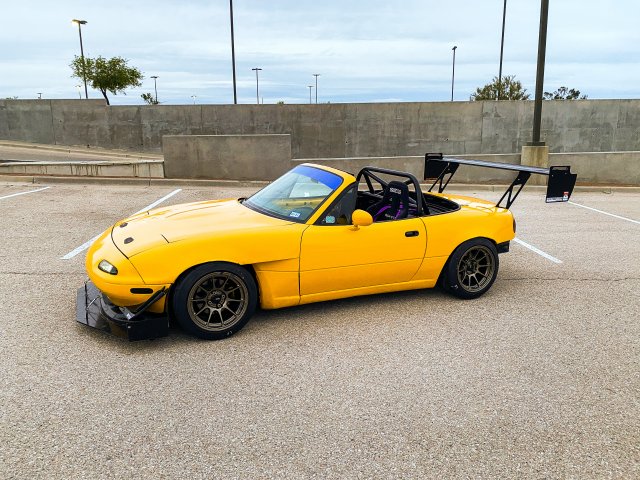

92 Miata is the racecar. Those wheels are 15x10s with 245/45s. Wouldn’t mind getting a set of AR1s for the track. But since it’s dual purpose with autocross, I might just stick with a good 200tw tire. 66D301C9-0337-43F8-AD81-C924C44C9B0D.jpeg

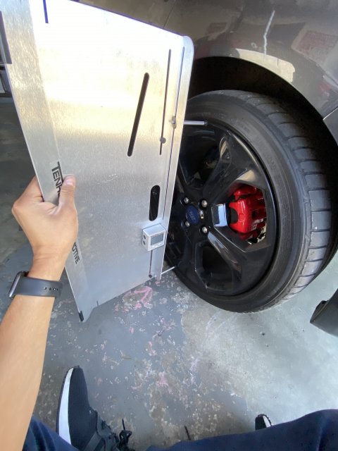

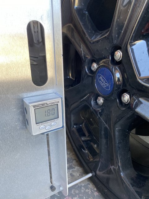

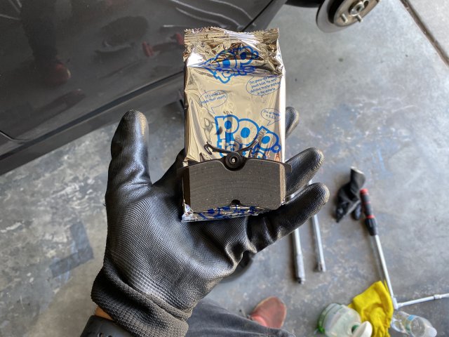

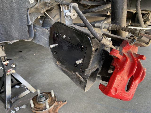

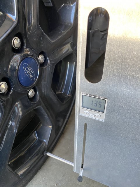

Installed front camber bolts and camber plates from Dpro. 5DD70464-A05A-41A7-A5EB-19EDB381D1AF.jpeg 21B3D00A-A07F-4D58-9489-A4A10376F907.jpeg Super surprised one how small the rear pads are. Literally the frosting area of a Pop Tart lol. 91D0F8F1-EDAF-4D2B-9DE9-12132AE3A4C7.jpeg Driver side camber is reading at -1.8 and passenger side is reading -1.35 using my camber gauge. I’ll have to get it on the alignment rack to get exact numbers. Not a lot but some camber is better than nothing. Should even out tire wear on hard driving. 8C36126F-CCC5-49A5-B6BF-F3A9F64BDE32.jpeg 236CEA40-EA00-47B6-8F5D-755E5BEE4A49.jpeg 61218F97-CA04-4CAD-B21F-11C39CA93305.jpeg

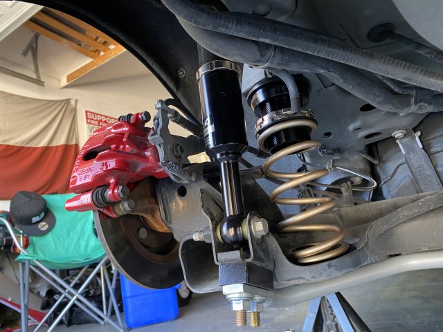

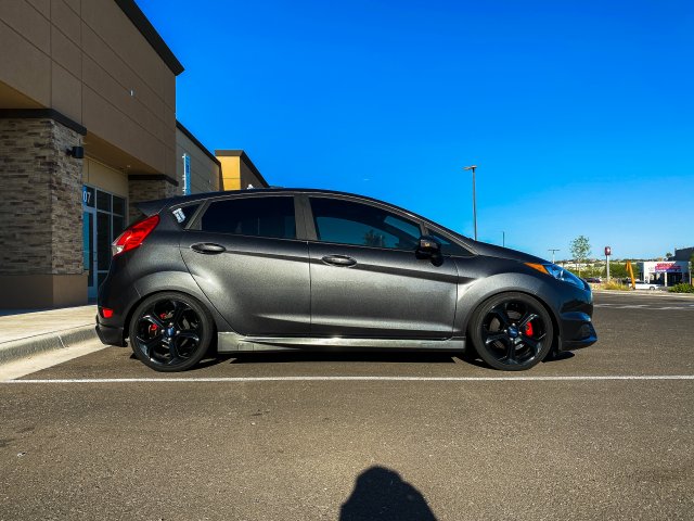

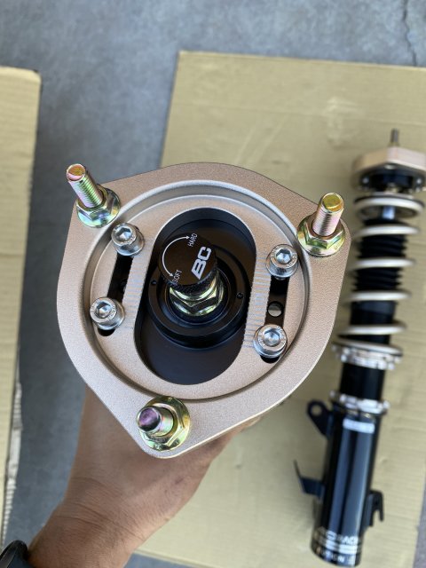

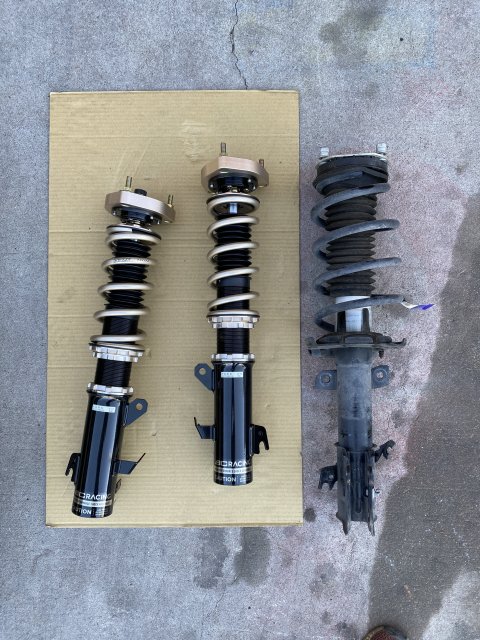

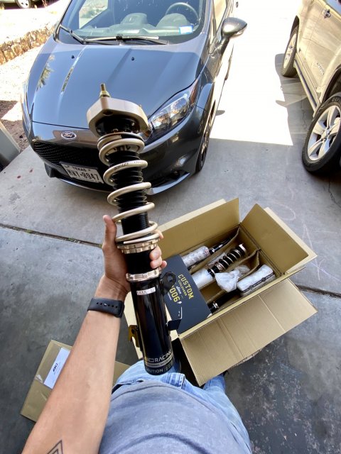

Picked up a set of BC Racing BR coilovers from Whoosh Motorsports. Went with the upgraded swift springs for this car. C2D24C6E-5547-4022-B0E9-B291B3980BFA.jpeg DC09787D-85EC-4AFD-B446-4C6103EDD890.jpeg DE40B9D8-F1A7-438A-ABE9-885C6C1F8CB7.jpeg 1A8680FC-3B79-482E-9652-F4C02CACB71E.jpeg These should hold up to all the daily and track driving I wanna do. 6F51C869-66F2-46AA-A53E-3E7933096958.jpeg EEE02246-D9EA-4A9F-8C36-497FA5A61C6A.jpeg Ride height is pretty much where I want it. Need to make a few little tweaks.

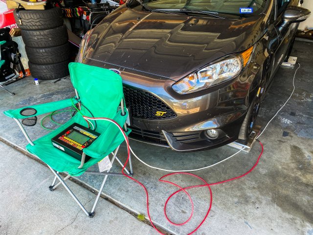

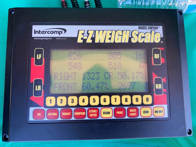

Pulled out the scales and corner balanced the car. FA1EE188-C1EA-4BD2-9C23-5645A18D1349.jpeg 23EE8BE5-885C-4B38-9FF4-DDD831382B19.jpeg 50.17% Cross weights is good enough for this car. 6B853D9D-7887-49DF-8E43-49DE826B5907.jpeg Roughly got the camber dialed in with my
camber gauge. Going to the alignment shop tomorrow to get it perfect. Can’t wait to get good tires on this car and drive it hard.
. I'm curious about that spring upgrade have any liner rubbing issues? What setting do you have the dampers? How is the quality of ride?
#4150
14,646
7,146
#31
SWEET that Swift paints their springs that same gold color as the hardware for BC's use with this kit. [:)] [thumb]
