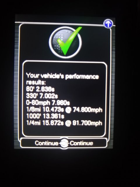

I was contacted by Cobb support today and asked to update my AP to a beta version of the firmware, v1.7.4.2-20221. I'm happy to report that this fixed the problem and I'm able to perform the 0-60 and 1/4 mile measurements now.
1.6
#14130
41
43
The fix is now out of beta and a part of the main update fork. Its cool that they listened and fixed the issue!

I updated my Accessport and the 0-60 and 1/4 mile feature now works!
Now can somebody explain why my 0-60 times are so bad? I guess all seasons and torque in first gear don't play well together lol
