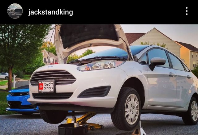

Tried to squeeze my head under there this weekend but I'll need to get it up in the air on jacks to get a better look.

I haven't had the chance or funds to do anything yet unfortunately. :(
Coaching peewee football has used up all my free time and cutting into work hours to make it there on time! Haha...
Now that it's getting darker sooner and we're about to roll the clocks back and I'll be driving in forever darkness, I need to get on this soon!
