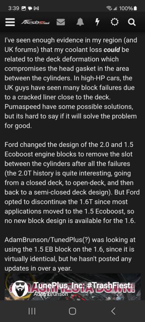

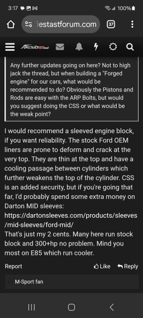

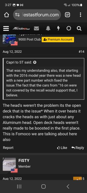

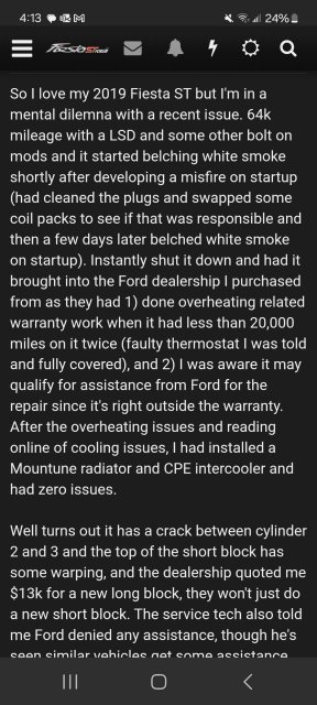

I appreciate the quick response folks! That thread on year changes was helpful n speaks to head related hotspots, which may be connected to the block issue. I posted 4 parts of several threads on this forum with guys talking about the block design leading to coolant intrusion into chamber, white smoke out of exhaust and warped/cracked block to where putting a new head gasket on will not fix the problem. Maybe more likely on high HP Fiestas? I would love to know your thoughts, as this issue is definitely chronicles under coolant loss etc on this site. Thanks in advance for any response!

The common thread in those threads is that the user overheated the engine to cause the problem. Overheating can be a problem in these cars, especially in modified cars run in very hot temperatures. Many drivers have never seen overheating, but it is talked about frequently. That's why so many use larger radiators and intercoolers.
