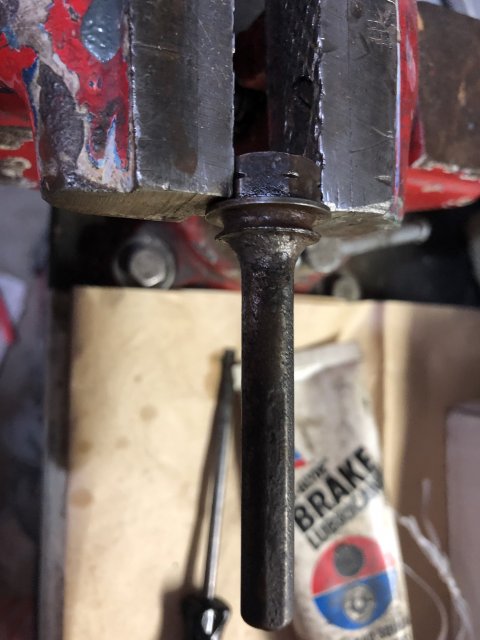

My rear brakes were dragging at 43,000kms and the sliders were seized and corroded. Please tell me I’m not the only one to find this.

Mine did as well. Ford didnt put enough lubrication in during assembly. I cleaned mine and bored out the holes with PB blaster and a wire brush. Lol. I nee dto get in and re grease them every 6 months just to make sure its good for summer and winter.

Seems like these vehicles comparably use a lot more rear brake. I actually wore those out before the front.
We used to have to just deal with road salt and eventually sodium-chloride. Now we have salt-brine and salt dust on the roads non-stop for a couple of months out of the year. Literally gets in every nook and cranny. Beet juice helps it stick around even longer. Get a nice pitiful drizzle and near sixty degree temps is the perfect storm. We rust out vehicles more thoroughly and efficiently than ever before. That pin is just a tiny taste of what's coming.
