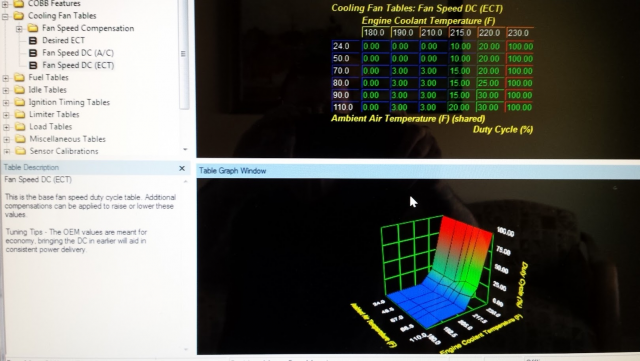

Here's a cooling fan table showing fan speed in relation to engine and air temperature that I ran across at some point, I don't know if this will be helpful to you, but I will attach it here just in case it is.

Here's a cooling fan table showing fan speed in relation to engine temperature that I ran across at some point, I don't know if this will be helpful to you, but I will attach it here just in case it is.
Thanks Buddy I saw that. It's what tipped me off about PWM control. Appreciate it

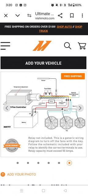

Alternately you can use the Mishimoto diagram and a separate switched relay or just wire it straight to the output of the cooling fan relay (which should be perfectly safe, it’s a 60A relay circuit that powers the factory fan), both of which will give you full fan whenever the ignition is on.
