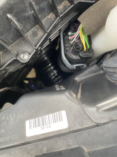

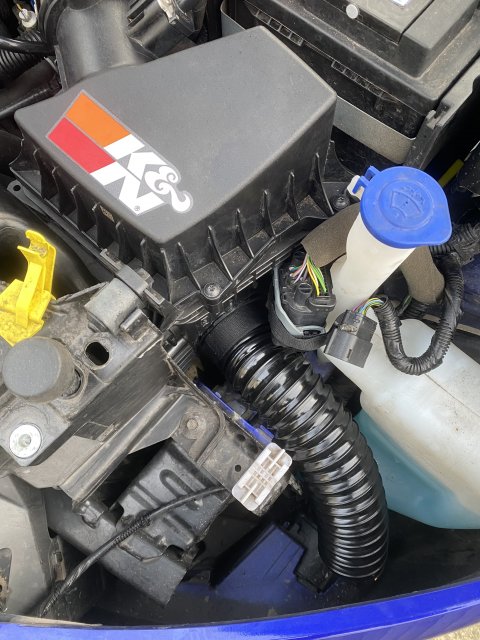

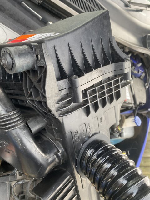

For those of you that are looking for a bit more intake noise out of your stock air box whilst keeping intake temps cool then this is your solution. I’m currently running this setup on with a Peron 1+ map and the noises this makes are addictive! Not too loud, not too quiet 2F2D6DAC-97CE-45EB-80A7-A8EB1983CC70.jpeg 8B001FD3-DF00-4221-9D56-ABA5F06644BD.jpeg 7E4FCF11-3D36-4976-A764-5DD3C212F354.jpeg

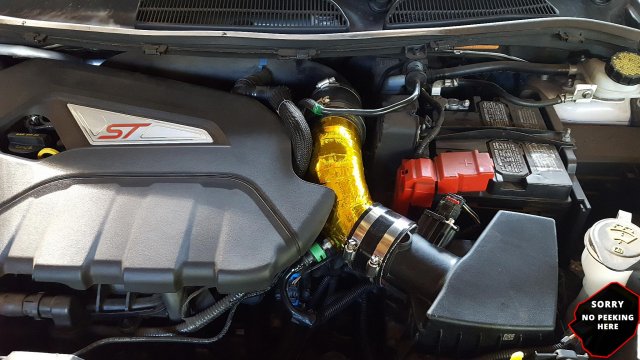

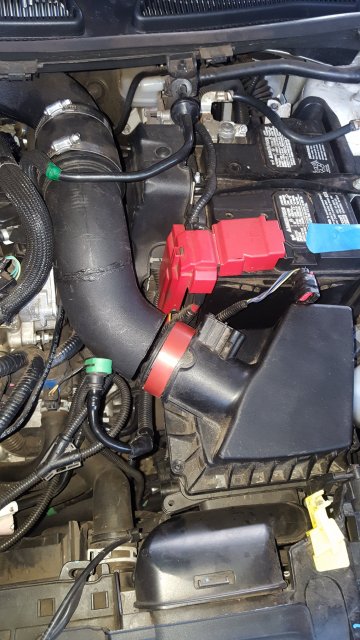

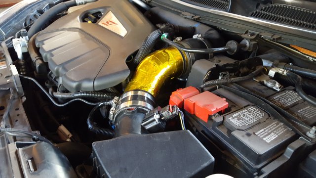

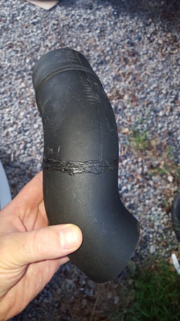

Good job. I thought I was the only one...lol. I did this little over a year ago. Very simple to do and the perfect alternative to the what I see as an overpriced st200 airbox setup. And the sound to me is just right. However I went a bit further and also made my own intake connecting pipe from a modified cobb primary to the airbox.
20190721_180557.jpg 20190721_180721.jpg 20191013_164713.jpg 20191013_164703-2.jpg
The only thing I plan on changing is adding a bit of upwards angle to the second inlet from under the headlight. Unfortunately I don't have a very good shot of it with the headlight in. I just used a silicone hose with a slight bend instead of flex hose.
