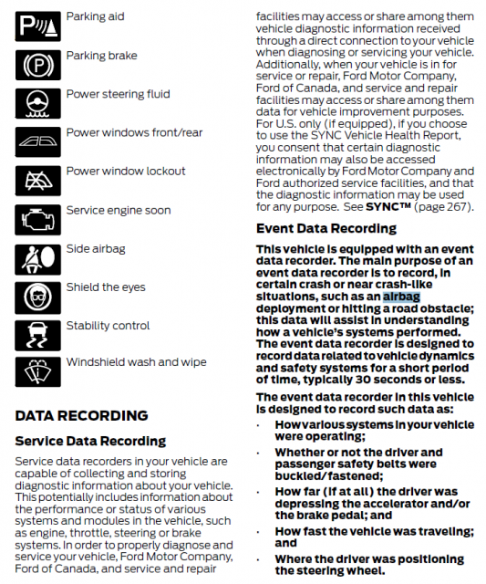

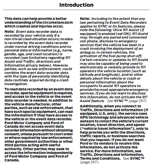

Take it to a dealer and they can pull the data; which presumably will allow one to determine exactly what set it off.
What I don't know is, how long this data is saved; whether it survives an ignition cycle.
EDIT: Next page...
