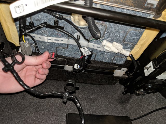

I switched out the harness for the underside of the recaro with the one from my stock passenger seat, I don't have forscan available today and when I turned the car on the airbag light went off for a second before coming back on. I'll try to clear the fault tomorrow in the evening and see if that helps.
While attaching the harness I noticed two connections that aren't made, I check the driver's seat and see one is connected but the other isn't. In this picture I'm holding the connection that is made on the driver's side, I believe the other connection neither use is the seat heater.
Does anyone have a picture, schematic, diagram of the under seat harness? IMG_20200209_152125.jpg
